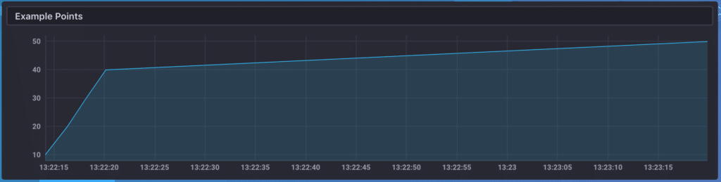

If this were a regular time series, then an average value of 30 would make sense, intuitively. Because our example is an irregular time series, though, the amount of time between measurements matters when calculating the final result. This becomes more clear when visualizing the values; here is what those points look like on a graph:
Our example data graphed using Chronograf.
We can see that the majority of the time is spent between the value of 40 and the value of 50 (we’re doing a linear interpolation between those points to draw a graph). We can make a reasonable guess, then, that the mean over time is probably closer to 40 than it is to 30.
