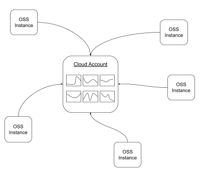

The last bullet is the most powerful and flexible way of maintaining and managing your fleet of IoT devices. That architecture offers you several advantages including:
  • The ability to perform tasks that prepare and clean your data before sending it to InfluxDB Cloud. This not only helps you create a well-organized data pipeline but also ensure that your data has been standardized across IoT devices
  • The flexibility to only send select data to InfluxDB Cloud, like anomalies that were flagged in the OSS instance
  • The option to isolate task workloads and keep them close to the data source
  • The benefit of an additional layer of security between your edge devices, InfluxDB Cloud instance, and end-customers
Architecture drawing of the last bullet. Sensors write data to an OSS instance of InfluxDB at the edge which in turn write data to InfluxDB Cloud.Write data to InfluxDB at edge to cloud

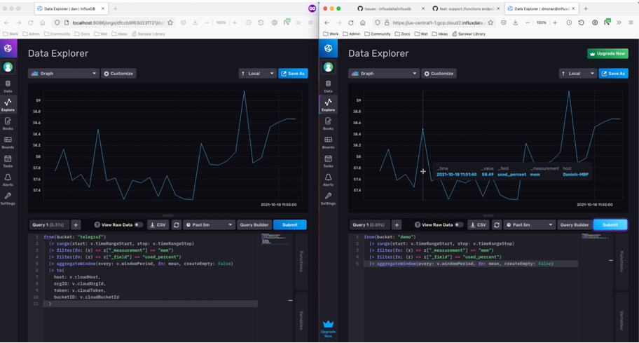

Using the to() function to consolidate data from OSS to InfluxDB Cloud
One way you can achieve this architecture is by using the to() function. The to() function now supports the option to write data from an OSS v2.1 instance to an InfluxDB Cloud instance.
Using the to() function in Flux - an example
Example of using the to() function to write data from an OSS instance to InfluxDB Cloud
On the right-hand side of the above dashboard, the user is querying an OSS instance. On the right-hand side, an InfluxDB Cloud instance displays the results of the Flux script in the OSS instance after the data is written to InfluxDB Cloud with the to() function.
To write data with the to() function from InfluxDB Cloud:
  1. Query for your data.
from(bucket: "RoomSensors")
|> range(start: -10m)
|> filter(fn: (r) => r["_measurement"] == "temperature")
|> filter(fn: (r) => r["_field"] == "temperature")
|> aggregateWindow(every: v.windowPeriod, fn: mean, createEmpty: false)
  1. Specify the destination host URL, orgID, token, and bucket ID.
|> to(host: https://us-west-2-1.aws.cloud2.influxdata.com,
        orgID:   04xxx00,
        token: 0xxx==,
        bucketID: 43xxx00)
