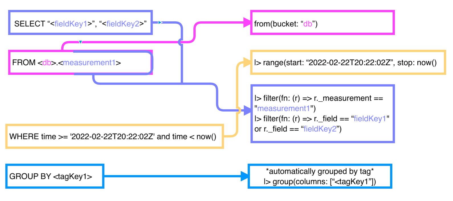

Almost every user will start by writing an InfluxQL query like:
SELECT "fieldKey1","fieldKey2" FROM "db"."measurement1" WHERE time >= '2022-02-22T20:22:02Z' and time < now() GROUP BY <tagKey1>
This is the equivalent Flux query:
from(bucket: "db")
|> range(start: "2022-02-22T20:22:02Z", stop: now())
|> filter(fn: (r) => r._measurement == "measurement1")
|> filter(fn: (r) => r._field == "fieldKey1" or r._field == "fieldKey2")
|> yield(name: "my first flux query")
Let’s take a look at how these two queries map to each other:
If you’re new to Flux, one of the first things you’ll notice is the pipe-forward operator, |>. Flux is a declarative language and is designed to transform data by pipe-forwarding the data between functions where each function transforms the data in order. You can see the code starts with a from() function and then pipe forwards the results of that from() function to range() function. You specify your time range with the range() function instead of the WHERE clause. Finally, you don’t need to group by tags because tags are automatically grouped in Flux. However, you could include a redundant group() function to group by that tag as shown.
The yield() function is what you use to specify what parts of your Flux query should return data and where you assign a name to those returned results. If you’re only querying for one stream of data as we are above, then including a yield() function is optional. The result will be named “_result” by default if no yield() function is applied. If you wanted to query for data from multiple buckets simultaneously, you would have to use two yield functions and name each result something different. This is similar to using the AS clause. For example:

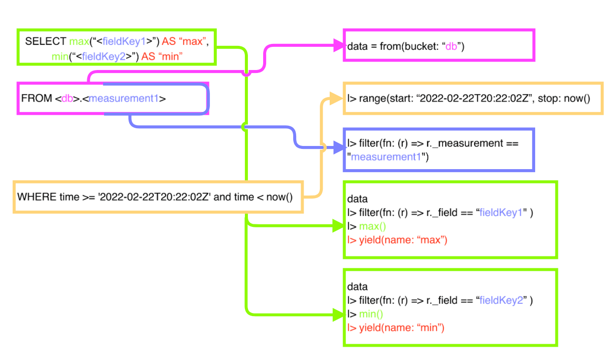

SELECT multiple aggregations → multiple yield() functions
If you’re comfortable with InfluxQL, then you’ve probably selected multiple aggregation before. Maybe you want to select the min and max of different fields like so:
SELECT max("fieldKey1") AS "max", min("fieldKey2") AS "min" FROM "db"."measurement1" WHERE time >= '2022-02-22T20:22:02Z' and time < now() GROUP BY <tagKey1>
You can do the same with Flux, but it requires more lines of codes:
//querying your common data once and referencing it with a variable
data = from(bucket: "db")
data
|> filter(fn: (r) => r._field == "fieldKey1")
|> max()
|> yield(name: "max")
data
|> filter(fn: (r) => r._field == "fieldKey2")
|> min()
|> yield(name: "min")
An aside: One of the first things InfluxQL users who are learning Flux tell me is that Flux is necessarily complicated. I hear things like “what used to be one line of InfluxQL code is now 10 lines of Flux”. I felt that same pain point when I started learning Flux, but now I far prefer Flux over InfluxQL. “Simple” InfluxQL queries might appear more complicated in Flux, but the degree of that complexity pales in comparison to the degree of data transformation and analytics power that Flux provides. You can build custom functions, pivot data, join data, write custom flapping algorithms, map across data, fetch and work with JSON, and so much more.
When writing Flux, it’s important to start thinking about data structure, hierarchy, and shape in your head. This is probably the biggest shift in thinking when it comes to Flux and InfluxQL. For example in the query above, you need to think about the common denominator in your query. In this case that’s querying for data from “db” and “measurement1”. Store this data in a variable and reference the variable. Now you can filter further for the specific fields that you want to find the max and min of (or “fieldKey1” and “fieldKey2”, respectively). Finally use the yield() function to name each result as you might have done with the AS clause in InfluxQL to yield two results simultaneously – both the max(“fieldKey1”) and min(“fieldkey2”).
You could have also executed the following query:
