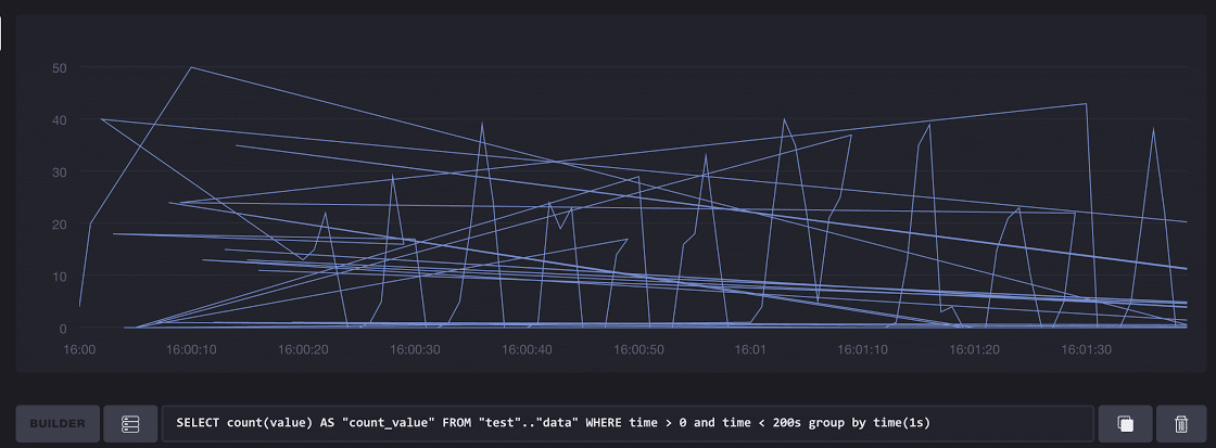

It all started when a new Chronograf ticket came in, where a user had reported their graphs behaving strangely.
The Bug
I give you ‘Exhibit A’, a screenshot submitted by our affected user:
Though this graph is quite the visual cacophony, the issue was clear immediately: Chronograf was plotting this user’s data out of order. For a product like Chronograf, this is about as critical as a bug can be. Because we’re in the business of time series data, we’d better be sure we’re respecting the laws of physics and that time continues to function as it has since the beginning of, well, time.
