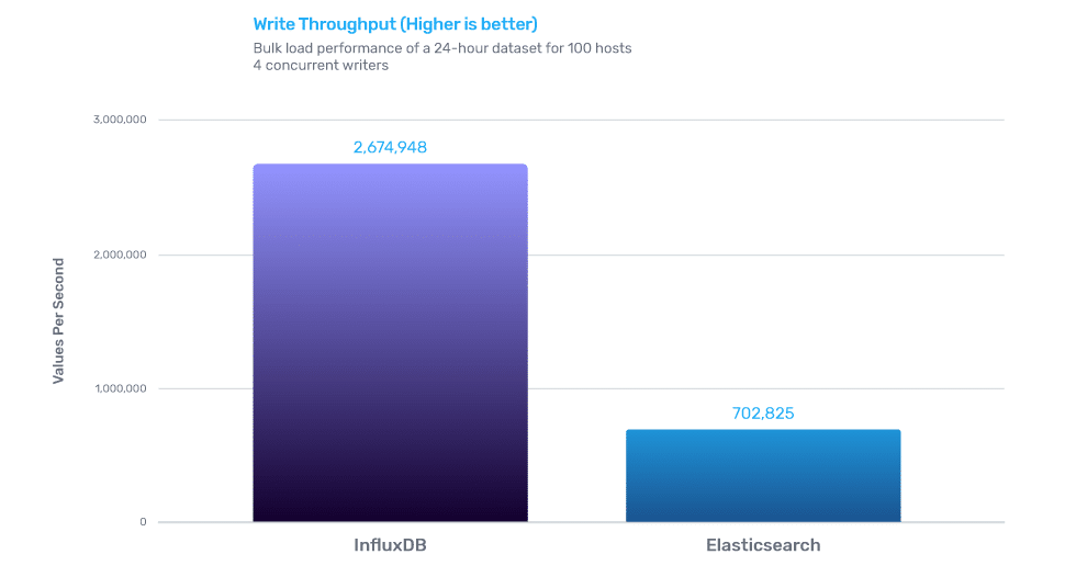

Write performance
InfluxDB outperformed Elasticsearch by 3.8x when it came to data ingestion.

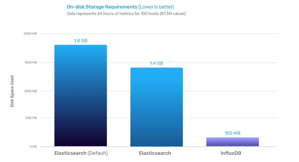

On-disk compression
InfluxDB outperformed Elasticsearch for time series by delivering 9x better compression.

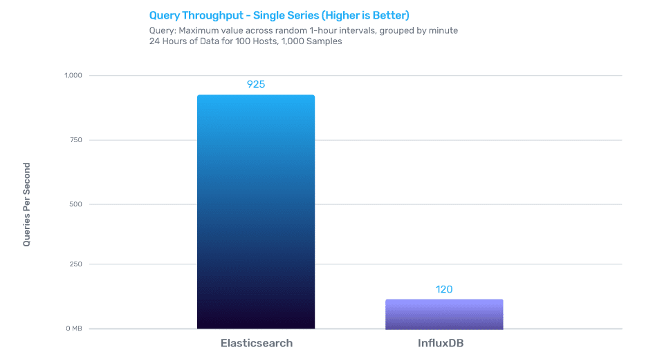

Query performance
InfluxDB for time series delivers 7.7x better performance, when returning cached queries.
