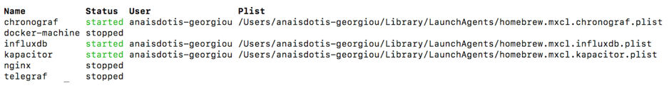

After installation, make sure that InfluxDB is running and Telegraf has stopped by typing the following command in your terminal: brew services list.
influxdb telegraf
If you don’t see that InfluxDB is running, execute brew services start influxdb. Similarly, if Telegraf is running, you can use brew to stop that service with brew services stop telegraf.

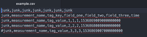

My csv data looks like:
influxdb telegraf agent
The first column and row are junk. I’ve also commented out the last row. My timestamp is in Unix time with nanosecond precision. In Step Two, I make sure not to include those rows and columns in my data ingest by adding some lines to my config file.

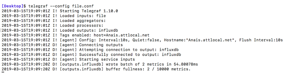

Step Three: Run Telegraf with the config file we just edited by copying and pasting the following line in your terminal:
telegraf --config $pwd/file.conf
You should see this output if you have debug = true:
Influxdb Telegraf Plugin - Telegraf Agent
