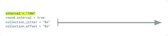

The default interval setting of 10 seconds collects your data every 10 seconds. If you wanted your data to collect twice as often, you would lower the setting to interval = "5s" for it to run at the 5, 10, 15, 20 and so on of every minute. The interval setting is rather straightforward but is also one of the most important configurations for the behavior of your data collection.
In the above graphic with these settings of interval = "10m" and round_interval = true, Telegraf collects data every 10 minutes on the rounded tens.

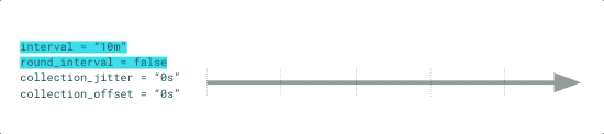

However if we change round_interval to false, Telegraf collects right when Telegraf starts and then continues at whatever interval is set. In the example below, we’ll set our round_interval = false and keep the same interval = "10m". If we start Telegraf at the 7th minute of the hour, Telegraf will immediately gather metrics and then continue collecting every 10 minutes on the 17, 27, 37, 47, 57 minutes of the hour.

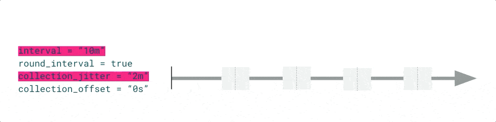

Offset collection by a random amount using collection_jitter
If a user has a large number of input metrics configured, adding some randomness to the collection process can help ensure targets do not get overloaded. You can use the collection_jitter for this exact use case to jitter the collection by a random amount. This setting can be used on the agent or input plugin level. If used at the plugin level, each plugin will sleep for a random time within the set jitter before collecting.
The range used for collection is between the interval and the interval plus or minus the jitter amount. So if we keep our interval to 10m and set collection_jitter = "2m", then each input will fire off randomly between the 8-12 minute intervals.

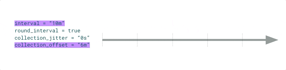

Precisely schedule collection with collection_offset
The collection offset setting is the new agent setting that was added in Telegraf 1.22. The collection_offset setting is used to shift the collection by a given interval. This setting allows you to avoid many plugins querying constrained devices at the same time by manually scheduling them in time, as opposed to collection_jitter that can enable you to randomly offset in time.
If you have remote data that gets updated at the same time in the middle of the night, you can use collection_offset to schedule the collection precisely after it gets uploaded and continue doing so on a daily cadence.
In this example, we will maintain the interval = "10m" setting, return round_interval and collection_jitter to default, and set collection_offset = "6m". No matter what time we start Telegraf, we will collect data on the 6, 16, 26, 36, 46, 56 minute of every hour.
Also as opposed to collection jitter, collection offset allows you to maintain a consistent and exact interval that Telegraf is collecting on. Collection offset provides you controlled data collection for predictable timestamps.
