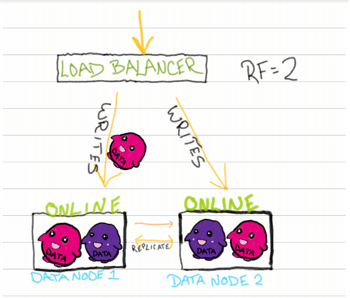

Let’s bring back our classic cluster: InfluxDB Enterprise with 2 data nodes and a database with a replication factor = 2.
The system is healthy and happy, sending data along to be stored and replicated. This is the happily ever after for our data, but sometimes we have to work to make that happen. Distributed systems change frequently, and dealing with that change is often what disturbs consistency in the first place.

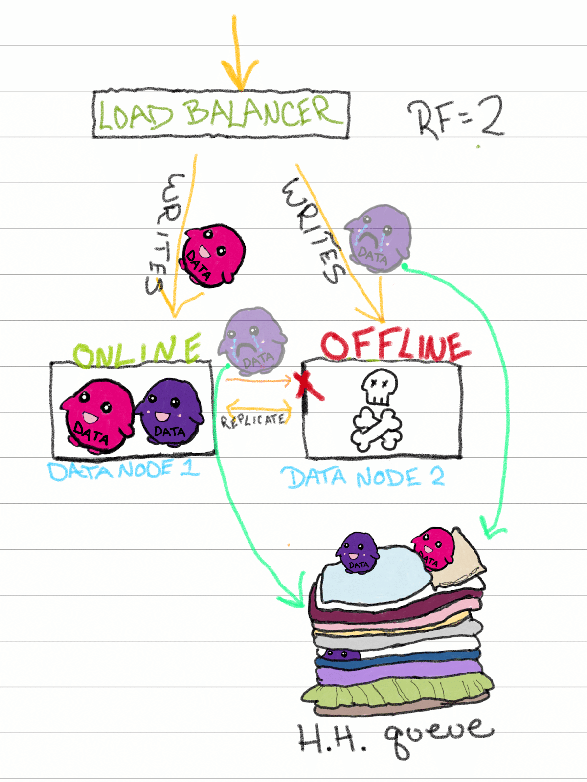

When Node 2 goes offline, any new writes are sent to the HHQ, where they wait for Node 2 to become available again. Reads get directed to Node 1, which has all of the same data as Node 2 (because of our RF = 2).

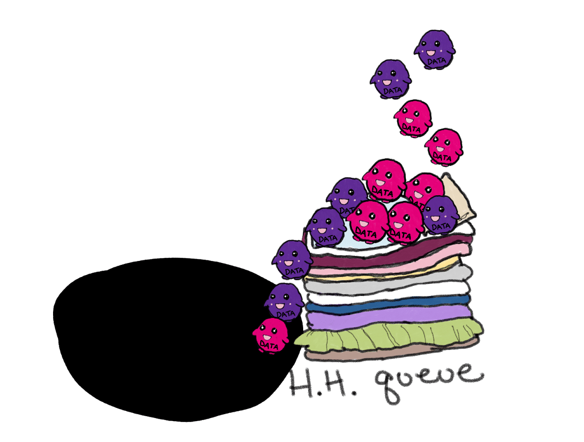

But the HHQ can’t keep holding data forever—it has some practical limits. In InfluxDB Enterprise, it defaults to 10GB, meaning that if the size exceeds 10GB, the oldest points will get dropped to make room for newer data. Alternately, if data sits in the HHQ for too long, (default in InfluxDB Enterprise is 168hrs), it will be dropped. The HHQ is meant for temporary outages and fixes that can be quickly addressed, so it shouldn’t fill indefinitely. It addresses the most common scenarios, but the HHQ can only bear so much of the burden.
In scenarios that have longer “failures”, there is more room for data drift between the two nodes that we want to be identical. If a node is down and goes undetected for an extended period of time, the HHQ could exceed storage, time limit, concurrency, or rate limits, in which case the data it was meant to forward on vanishes into oblivion. Not ideal. Of course, there are a large number of potential edge cases that could happen: the goal of the HHQ and AE service is to provide a way to ensure eventual consistency with minimal effort from humans.
