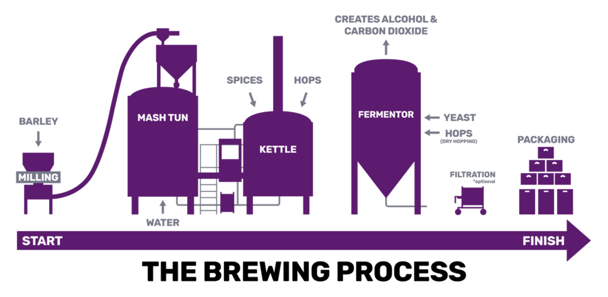

How is beer made?
Comparing the commercial and home brewing process
As seen above, brewers at home are generally able to skip the milling step and go straight to the mash tun. Usually homebrewers will purchase grain that has already been malted and milled. Luke’s setup is even easier as the mash tun and kettle are the same machine. It is common for homebrewing setups to include a machine that does both. Filtering is less common at home, as it requires more machines. Packaging at home means bottling or pressure-transferring it into a keg.

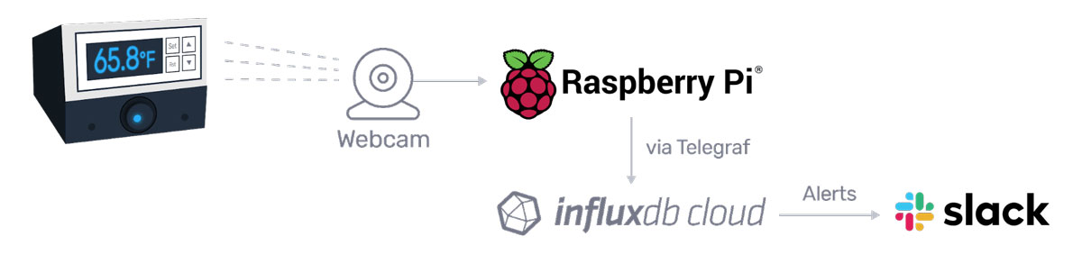

Automate everything! Luke now uses a myriad of technologies to collect and analyze metrics about his beer-making activities. He uses Telegraf to collect temperature metrics and sends them to InfluxDB. Once the metrics are in the purpose-built time series database, he easily creates useful dashboards and alerts.
Luke's IoT monitoring solution

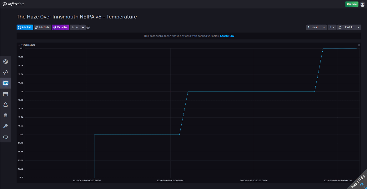

Luke has a cooler that automatically turns on to reduce the temperature. After the dramatic drop, the temperature begins to slowly climb again. He added code to reject values above 28ºC — this resulted in a lot of erroneous notifications. His dashboards even show a time where he must have accidentally kicked the webcam while passing — his graph displayed a lot of rapid up and down. Luke created a rule where he gets an alert in Slack whenever the temperature rises above 21ºC. This indicates that he needs to check the ice level. He also received deadman alerts when there was no data coming into InfluxDB.
Examples of Luke's dashboards and notifications
