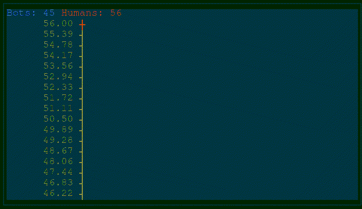

The sample Node.js CLI application consists of two components. The first consumes stream messages and writes them as data points in the InfluxDB database. Second, there’s a reader that queries the database to render the results of the query as a simple line chart. Time is rendered in the x-axis, and the value of the series in the y-axis.

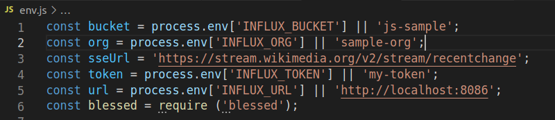

Once you have the token created, set the values of the following environment variables with the values of your local installation:
- INFLUX_ORG
- INFLUX_BUCKET
- INFLUX_TOKEN
- INFLUX_URL
Those variables are read in the env.js file, with some default values.

Once the data is in the bucket, the InfluxDB JavaScript client provides another API client to query the data. In this example, theInfluxDB object runs a query that returns the number of data points grouped by the isBot tag in the last 10 seconds:
const query = '\
from(bucket:"js-sample")\
|> range(start: -10s)\
|> filter(fn:(r) => r._measurement == "edition")\
|> group(columns: ["isBot"])\
|> count()\
The query is written in the Flux functional data scripting language. This is designed for querying, analyzing and acting on data over InfluxDB 2.0. The previous language, the InfluxDB SQL-like query language, is still supported at the /query compatibility endpoint of the API, but the recommendation is to use the full power of the new language.
As you can see, the query defines the bucket, range of data, filters to be applied, grouping columns and data functions to be applied. The following function shows you how to run the query against the QueryApi:
function queryExample(fluxQuery) {
const queryApi = new InfluxDB({url, token}).getQueryApi(org)
queryApi.queryRows(fluxQuery, {
next(row, tableMeta) {
const o = tableMeta.toObject(row);
pushRow(o);
render();
complete() {
console.log('FINISHED')
error(error) {
console.log('QUERY FAILED', error)
For each row returned, the data is parsed into an object and passed to a function that stores it in an array based on the isBot attribute. The two arrays of the series, bots and humans, are then rendered using the asciichart library. The full code for the reader is shown below:
