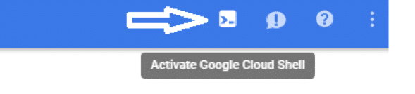

On successful login, look at the top right near your project name and you should see the Activate Google Cloud Shell icon as shown below:

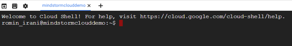

shell Click that and wait a while for the VM to be provisioned the first time and activated. On successful activation, you will see a terminal slide up as shown below and there is your development machine in the cloud:
shell2
You can now go ahead and use several of the tools / developer SDKs that have been pre-installed for you.

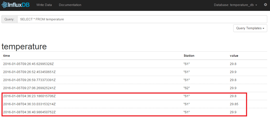

We can query if our records have gotten created via the Web UI or even via the HTTP API.
temp2
